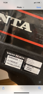

Hello guys, I have question regarding my propeller, I have regal 2100 with Volvo penta engine. I bought it with15x17 three blade propeller, after checking with techs found out this is not the right application for my boat . I am here to confirm if the information I got is right .
They told me the right propeller for my boat is 14.25 X 21 with three blade .
But when I made my research I saw people saying the best propeller is 14.25 X 19 with four blade . So can you please advise me with the right one.
By the way when I have more than 7 people in the boat I am facing hard time to coming out the hole. Also it’s hard for wakeboarding comparing with other boats.
My boat info
40869324
A196003
50gxic270r
I appreciate your help

What is the WOT RPM you are currently able to get the motor up to running flat out.

I bought it with15x17 three blade propeller, after checking with techs found out this is not the right application for my boat.
There is no right or wrong application for your boat. You can run any prop you want that lets the motor reach recommended rpm range at WOT
Best at doing what?
Generally speaking, 4 blade props give more lift on the low end but require more HP to twist. They also loose efficiency as they increase in rpm compromising your top end speed.
It all comes down to what performance traits do you want or what performance issue are you trying to solve
At that point, the vessel is likely overloaded and you’re out of horse power. Need to lower the pitch of the prop to gain RPM
Bear in mind the number of people noted on the boat’s capacity plate assumes each person weight #150 pounds.
