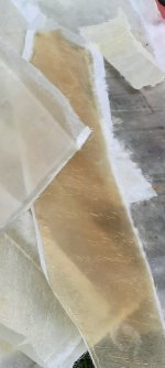

So Im pretty much over poly at this point. Ive been through 3 1/2 gallons of resin and about 15-20ft of csm and have nothing to show for it. I can literally pull it off in one piece like its a mold. Ive pre coated the wood with a few coats and then laid the csm down. Ive tried it just a layer of resin and immediately following up with csm and same thing. Ive sanded and wiped with acetone. Ive tried not sanding and no acetone and same result. Ive mixed it at .75% 1% 1.5% 2% and even tried 4% swinging for the fences lol. I got a quart of resin from the parts store and followed the directions and same result. It cures and just peels right. I dont know what else I can do.....

I tried that, I did 1000ml of resin and 10ml mekp. Then went to 15ml mekp when first batch didnt work. I dont have many pictures from when i was doing it. I didnt want to get resin on my phone. Maybe this will help. This is some of the old pieces I pulled off. You can see some of it tried to stick. But its not sticking like it should

Im not sure how old it is. But I figured when I got the quart from the parts store it would be a fresh batch. I dont think the mat is resin starved. Its fully transparent and Im pushing off some excess resin as i roll it out with the grooved roller....

Re-reading original post, the breakdown is somewhere in the details:
Tried good prep, failed to bond
Tried better prep, failed
Tried worse prep, failed
Modified MEKP ratio, failed
Appears to be wetted out, but are you wetting CSM before or after you lay it up.
As mentioned, it's extremely unlikely to be type of ply chosen. And unless stained, CSM is unlikely to be damaged. Perhaps humidity is a factor. CSM isnt at all damp? Already applied & prepped wood is washed/flushed well w acetone, not just a damp rag? Heavy on acetone may remove even the slightest hint of moisture due to humidity, but not for long in most of the US. It's nearly unbearable outside here today.
Moisture
Old resin
Old MEKP
Application error
But not ply choice
PreWet CSM before layup

These were on different pieces of boards. It wasnt just a bunch of failed attempts on the same board. I have not tried wetting out the csm and then applying it. Seems like it would tear/fall apart while being moved. I dont see where it would be bad resin or mekp because I got a batch from the store and had the same results.

I think the "parts store" resin is the key here... if you mean autoparts store, then its most likely not laminating resin... it probably has the wax in it to fully cure so it can be sanded for body work...
Maybe I missed something, but that would be the smoking gun in my opinion...
As others said, the wood isn't your issue..

If in fact you are using waxed resin you must sand/ grind between coats. The wax layer floats to the top and will prevent a good bond without getting rid of it.
