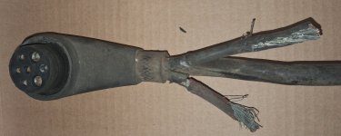

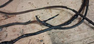

Thanks for the feedback. My boatside harness is just as bad as the engine side. check out the pics. I've found lots of sources for replacement harnesses, just $300 for the boatside and #175 for the engine side. I'll checkout surplus unlimited.

Gee, those look like battery cables. If that is all that is wrong with the boat harness, new ones can easily be spliced in.
Usually it is the quick connect that goes bad.

Every single wire on both harnesses is like that right up to the connector. Nothing left to splice too.

You can always make a new boat wiring harness. Measure the wire gauge of the old harness and buy some wire to match. Cut the wires and using different color electrical tape, wrap the new wire ends for identification.
Your motor likely has red for battery, black ground, black/yellow for spark killer, grey for tachometer, yellow/red for starter solenoid, purple for ignition power, and yellow/black for choke. You may have the old wiring colors, as your motor was likely made during the transition.
There are all kinds of products to hold the harness together, including electrical tape. Find an Amphenol connector that is suitable for that many wires and solder it on both ends, as well as the ign keyswitch.
I would route new battery cables directly from the battery to the starter solenoid and frame ground, bypassing the quick connector.
