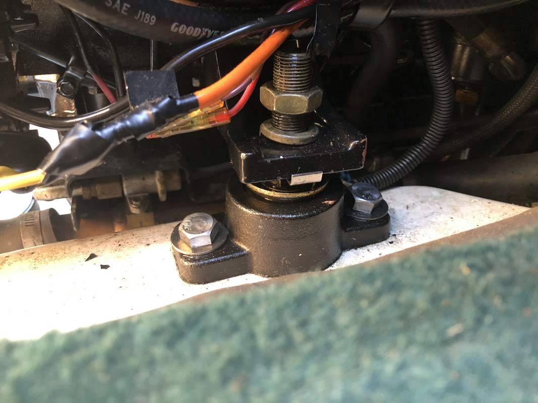

Think I found the problem!!! Was going to pull the plugs, and saw this!
