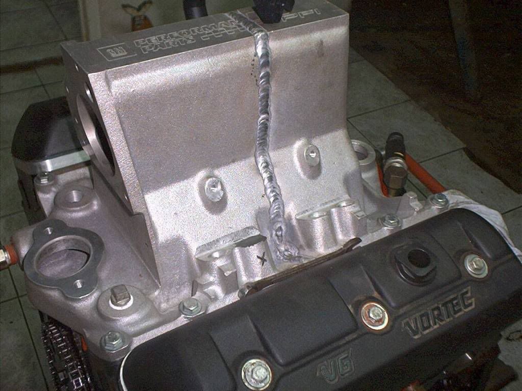

Another big speed bump is the intake manifold..i posted a pic of a truck it was the 4.3 zz. That engine was 270 from the factory..It has a Ramjet intake. Get by those two speed bumps and 300 is pretty easy today.

The marine intake and the 2114 are the only game in town so what are you going to do..Find a 1 or 2" spacer to open the plenum up. You want the engine to see both injectors a dual plane will split them up.As to the Ramjet intake there are none. GM never released the 4.3 zz engine and only made one...But you could cut up a 5.7 and weld it back together....:laugh: It's actually been done.

Finally found that old intake mod
Photo and image hosting, free photo galleries, photo editing
And remebered why i didnt use a 2114 its a dual plane and they split the engine or the carb tbi etc and could cause fuel distribution problem's. Now its been done in cars...a lean burn in a car can be tolerated not a good ideal in a marine engine. The marine intake for the v6 is actually a single plane with a divider...now why would they do that when a dual plane does provide more low tourqe. The only thing i can think of is fuel distrubiton. And may have a advantage with tbi...tbi does not rely on a signal like a carb nor atomization. it couold be very possible that it would provide the same low tourqe as a dual and the added benefit of higher flow rates.....I can turn my v6 to 5500 and it pulls hard all the way there.
