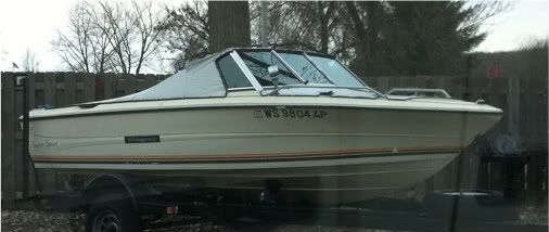

I'm not an expert... does this look like its sitting low (taken yesterday)?
At rest in the water with no people on board, the waterline stripe should "just" be out of the water across the transom. If its under water you have water in the hull, or one heck of a load of beer on board.

By waterline stripe I assume you mean the 3 parallel vinyl strips?

The port side looks lower than the starboard, but there is a full 17 gal tank sitting all the way aft, port side.
here is an out of the water comparison. those lines are pretty darn low, those are supposed to be out of the water?
Yes, that's the waterline stripe.
I got my information looking at the 1983 Stingray catalog. The pictures there are a bit clearer than the one you posted.
Mine is a 19' model and I have the same fuel tank configuration. Except that I also have a aux 9.9 outboard on the stbd side, plus a 6 gal tank right in front of it. So, basically, I'm a little stbd heavy, and thus mine at rest leans maybe 1/2" to stbd. I never ran the boat without the 9.9 so I don't know what it would be with the factory config.
Regardless, since your battery and trim pumps are mounted stbd, my guess would be that it should sit pretty level.

The furthest rear of the top stripe is only about 1" under water; that doesn't seem like much to me. Especially with full tank and a heavy 750 cca battery.
