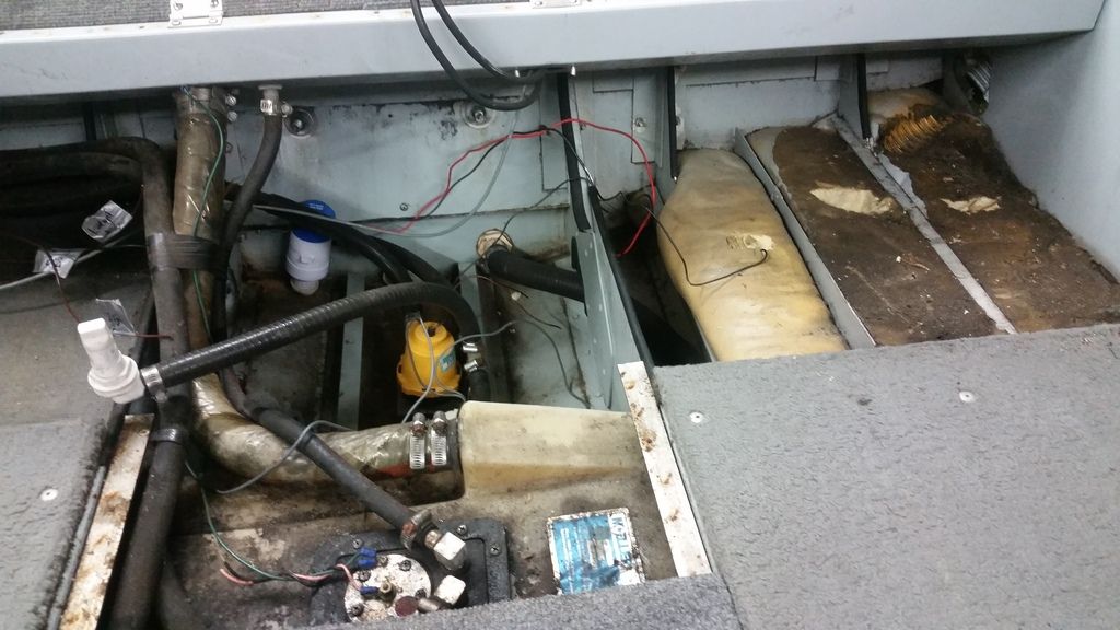

From the looks of the carpet, the deck (or hatch) above the tank has been pulled and recarpeted more recently then the rest..

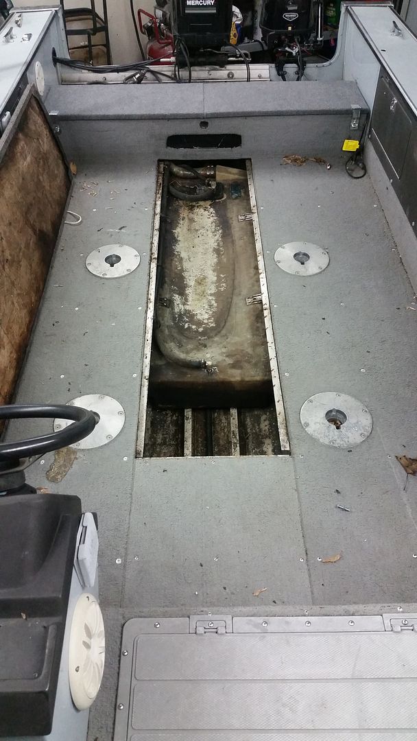

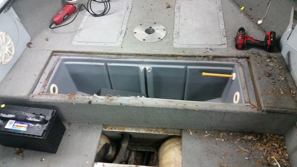

I'm getting a quote on a custom aluminum tank. I'm having them quote a replica of the current poly tank as well as a longer one for some added capacity.

Well, high heat probably didnt contribute to the tank damage...

With the tank top being slanted like it is, I think it throws off the sending unit/tank float. It is crooked in the tank now. It's always been erratic.

The top isnt supposed to have that dip in it, esp not 1 thats off center. You bet it'd throw the fuel sending units measurements off.
W the staining, it would appear water has sat on tol of the tank for a while, a good long while.
In MN, freezing water expanding might deflect the plastic I suppose.
Based on that, I'd suggest core sampling a good bit of the float foam as I described in that topic

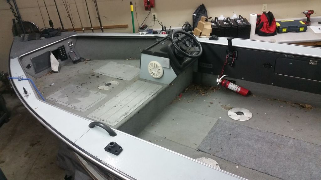

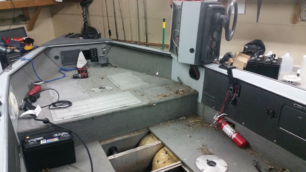

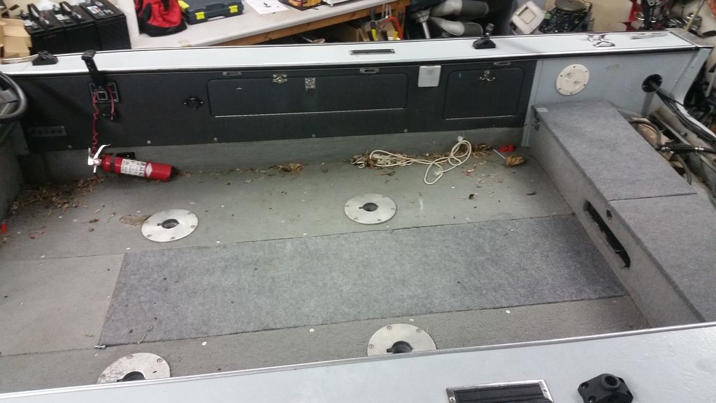

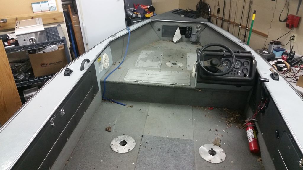

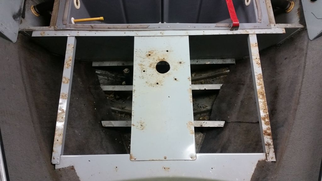

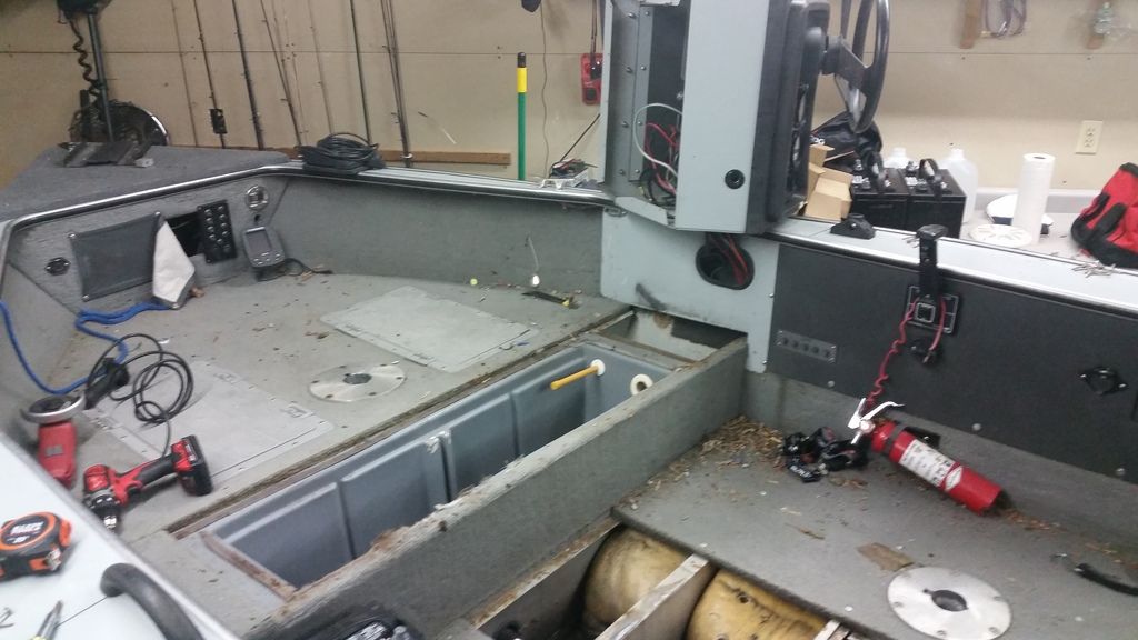

Day 2 took me about 3 hours just to remove the bow pieces. A combination of rusted bolts and removing the hatches, wiring, etc took way longer than expected.
I'm debating whether I want to move my livewell back by the motor and build repurpose the space for four batteries or not. Thoughts?

Ordered a new gas tank yesterday. It took some time to find a tank that would properly fit in the space below the deck.

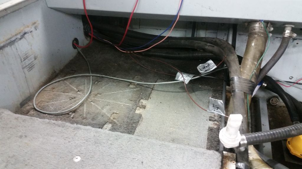

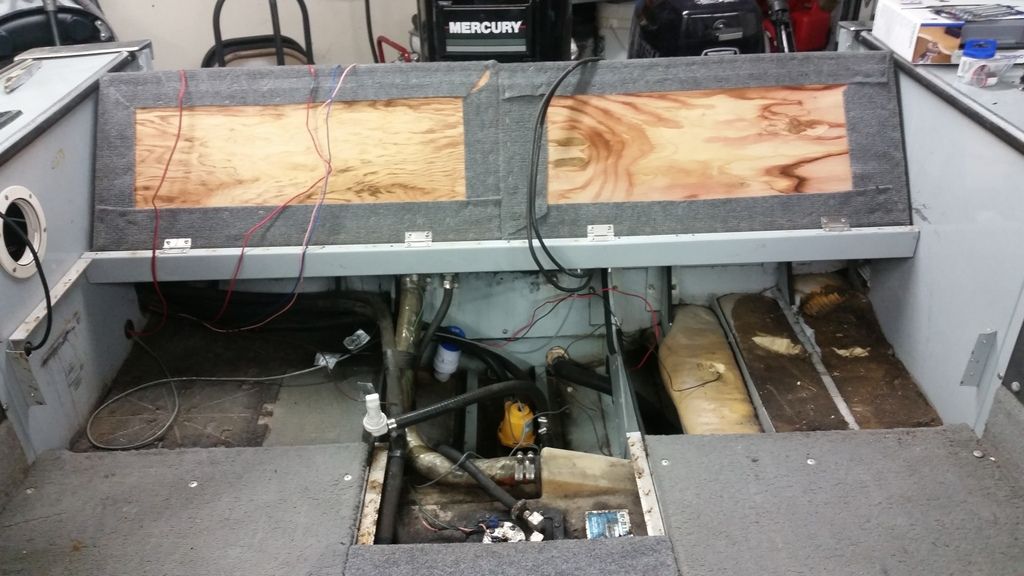

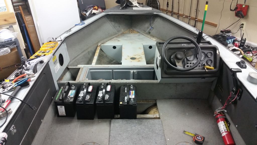

I took out the storage areas that have access to the bilge in the back of the boat. The wiring was a nasty mess. I'll be rewiring the boat after I move the batteries. I have 4 batteries now. Two are for the trolling motor. One is dedicated to electronics and lighting. The fourth will be dedicated to starting and emergency systems like the bilge pump.
I'm debating whether to move the batteries up by the console on the starboard side like seen in the pictures. Each battery system will have a disconnect and be routed beneath the deck in conduit. Thoughts?

Day 3, 4, and 5....

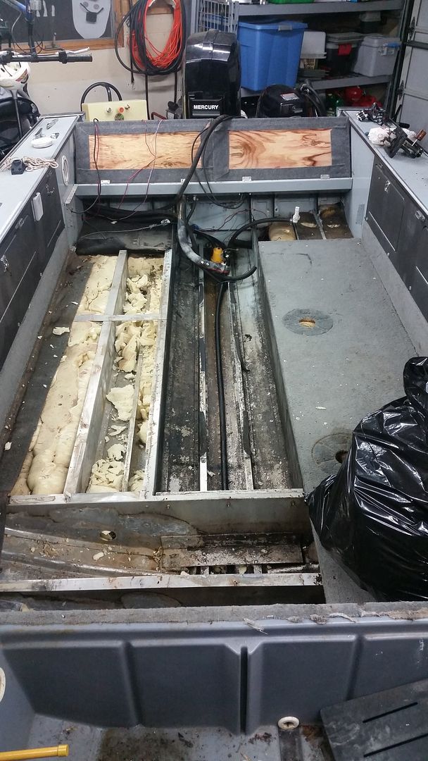

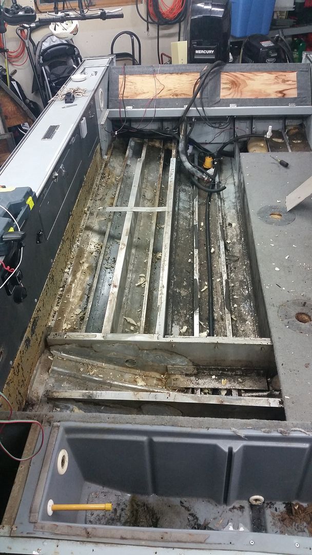

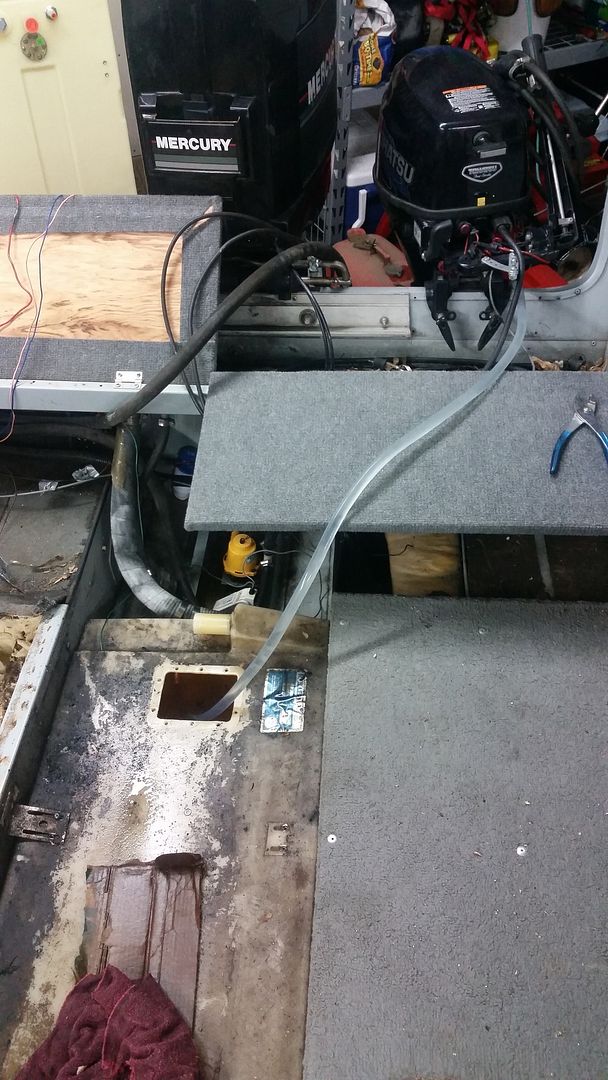

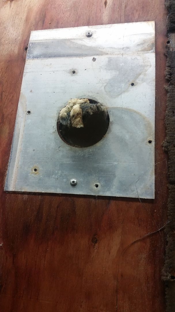

Started removing some foam. It's been a slow process! I also removed the gas tank. Bought a replacement. Went to 25 gallon. The old tank was a 27 gallon but it was caved in so far it was probably really like a 25 gallon. It caved in enough to throw off the sending unit. This new tank was less than $250 shipped to my door and included the sending unit.

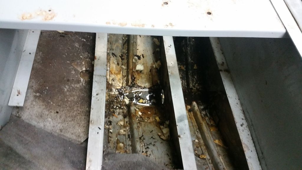

I was surprised to see that Lund reinforced the underside of the floor where the seat bases are.

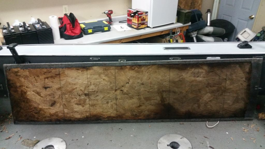

WATERLOGGED FOAM!

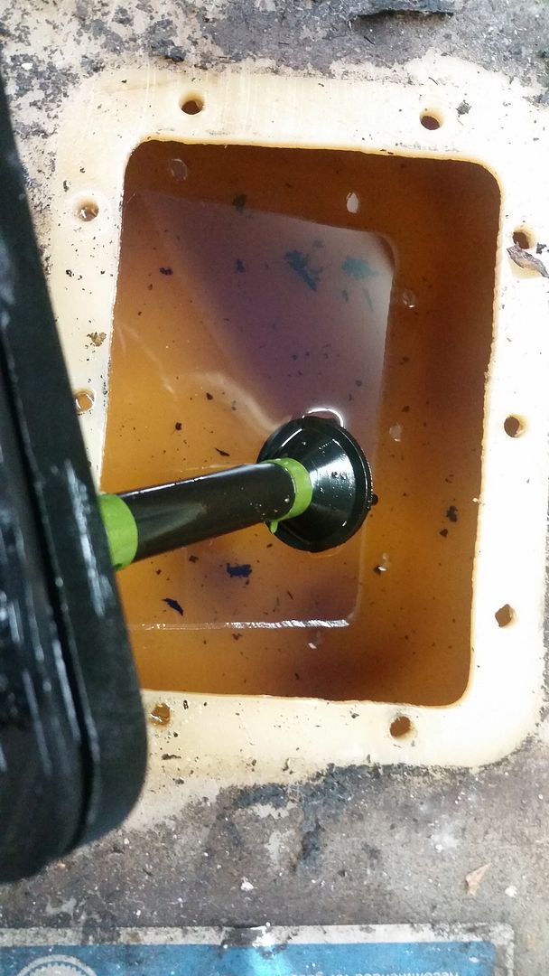

Siphoning gas out if the old tank
Crud that fell in the old tank. Filter it and stick in my car gas tank?
Tank is gone! Now I really need to spend some serious time on the rest of the water logged foam...

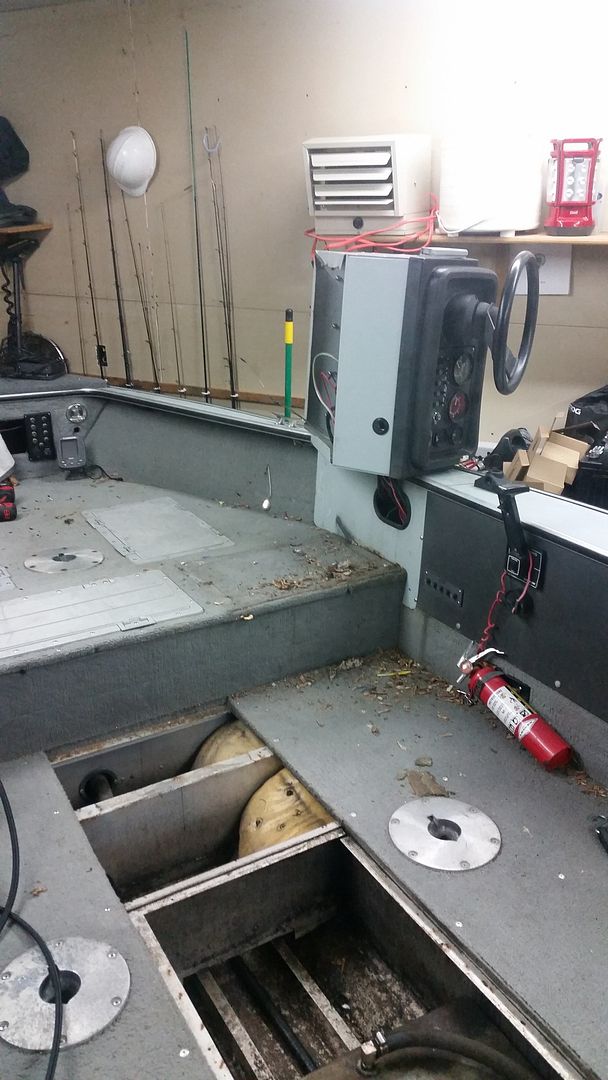

Day 6 involved removing foam. Stupid water logged foam. One trash bag I pulled out must weigh 40 lbs.

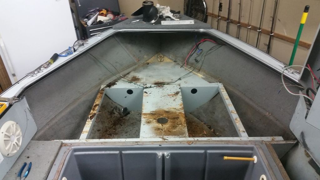

Bow foam gone.
Half of the deck foam is now gone too.

A slow process for sure but steady forward progress is key. Guys have used all kind of hand tools to dig out that soggy foam, you using a shovel or hand trowel?
redarndt
Seaman Apprentice
Apr 8, 2015
42
I'm using a flat wrecking bar and a shovel.

After going through the hell of removing the pour in foam, I've decided to go with sheet foam.
A very good idea! If you take your time cutting and fitting, that sheet foam can be just as good or better. Here's a pic of how I was able to lay the foam in my SN so it added to the deck support.
