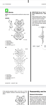

I am replacing the reed petals on 2008 50hp Mercury 2 stroke.
What is the direction of the 3rd hole on the petal. I'm assuming it goes on the right side over the small open channel, but does on the top or the bottom? Thanks

No pictures at the moment. Not sure why I need to explain why I'm changing them but here it goes
I'm not a professional but I'm willing to work on anything. The motor "sneezes" at low idle. After researching, I found that the reeds could be the problem. I didn't want to tear it apart and not have the parts on hand so I went ahead and ordered them. So since I had them, might as well put the new ones in. Although I did find that the check valves on the intake face are bad and that could be part of the problem. They should be coming any day.
Back to the reeds. There are 3 holes. 2 of which are for 2 pins that hold it in place. The third sits over a small channel that connects a shallow chamber to a deeper chamber. This hole is offset from the other 2 holes and I don't know if it should go towards the top or towards the bottom. Or if it makes any difference.

Not familiar with the 2008 50hp, but does the reed plate look like this?
39,461
Mercury parts books do not show reed stops on this style of induction set-up.

The odd hole goes over that channel I'm pointing at. Either on the top or bottom. Maybe it doesn't make a difference and that's why it doesn't really show in the manual.

Being that that hole is covered by the Retainer, I don't think it matters. FWIW, if the 1st pic were the Reeds that were in the engine, they looked from this angle, fine.
Don't forget to install new Locking Tab Washers, and use Locktite on the bolt as instructed in the Service Manual

I didn't know why up or down would make a difference but I never gave it a thought about it being under that retainer. Good observation. I'm gonna go with that. Yes, the old reeds were fine, but since I was in there and had the parts. Never hurts to have new parts. Thank you sir.
