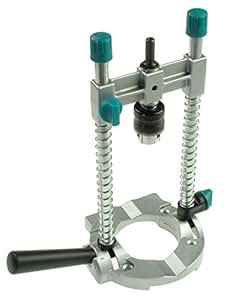

So... I need to drill the transom garboard drain and the motor mounts. All prior drilled out and filled w/pb.
I've seen using the drill guide I guess the need is to drill a straight hole in reference to an angled transom. Any suggestions appreciated.
Someting like this. are ther alternative ways to do this without the tool?

That's what I use. For small jobs I have a set of drill guide blocks, but I prefer using the one like that where I can.

careful some of those only have a 3/8 chuck gets very maddening, i have 2 now because i didn't read closely and thought it came with a half inch chuck lol

When I drilled mine, I made custom blocks from hunks of scrap hardwood.. I drilled a hole using a drill press so know it's square, then aligned and clamped it to the transom.
1" thick metal would be better but not many people have that lying around.
I never liked how flimsy those drill attachments looked.

I used 2 2X4's made them perfectly square as I could get them. Glued and screwed them. Drilled pilot holes first to screw them. Once they were done I just held them to the transom and used the edge where the 2 met to lay the drill bit. Drilled slowly.
I never had any trouble getting the gimble to slide in place going on. I drilled a little big. Glassed in the holes to seal them. Then redrilled them so the bolts fit again.

Yup, use some scrap 2x lumber and drill the correct sized hole with a drill press. Hold it flat against the transom, insert the dril bit and drill em. Eazee Peezeey and they be true to the angle.
