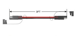

Buy this, cut it into a 12" piece and a 24" piece.
Splice the 12" piece on in place of the clips.
Add terminal rings to the 24" leads and connect to the battery.

If you had access to the connectors like I do, I would suggest an Amphenol ATP-06-2S and ATP-04-2P connector and terminals. however what Roscoe has above is very easy to source locally and get done today.

Decided on this. Actually going to cut the connectors off (save for another day) and butt connect from the charger to the clips on one side and the trolling plug on the other.
