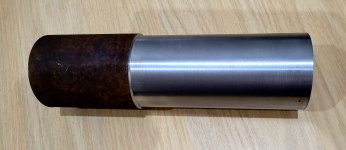

Managed to get some EN50 pipe, from a friend ... he even turned down a portion of it to match the dimensions of the VP tool.
I'll cut notches tomorrow, and weld on a 30mm nut on the rear.
Simple Q ...... assuming front prop (inner) is left hand threaded nut, and rear prop (outer) is right hand threaded nut.
As there is no locking tab washer or split pin .... what keeps the nut from working loose ? Particularly the rear (outer prop) nut.
