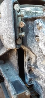

The quad gear is already removed. I need to put the quad gear back on BUT the drive leg is stuck in the full down position and 2 men tried and cannot manually lift it (it doesn't budge).
Next Ill loosen the pivot cap bolts. Do you need to remove the pivot cap cover to remove the pivot cap bolts? They look hard to get to.
What is the purpose of connecting a ratchet strap to something? Is it to provide more force to pull the drive or is it to keep the drive from falling on the ground? Want to know what to connect the ratchet strap to.
Picture of pivot cap bolts and removed quad gear attached.

connect the ratchet strap to the lower unit
the two large hex bolts are the cap bolts. just a turn is all that is needed.

Here is my guess. After you removed quad and let it drop it must have hit hard on the 2 alignment pins and got wedged because it did move at some point. Loosen or remove side caps, loosen pivot bearing caps and lube with something. Attach (choke) a ratchet to the bottom of the outdrive leg and attach the other end to a truck, tree or a heavy mama...
Put tension on strap and wiggle and shake drive. Dont pull too hard cuz you dont want to break anything and spray penettant on those tapered pins.

Im thrilled to report success in getting the drive unstuck, getting the quad gear back on, and the tilt motor is working perfectly, using the tilt switch, it automatically tilts the drive up and down. Thank you all for you time and advice! it WORKED!!
What I did:
I loosened the pivot bolts and the stern drive manually lifted easily, no ratchet strap was needed.
I pumped grease into the fittings while the pivot bolts were loose.
With the drive in full up position, I bolted the quad gear back on.
I sprayed penetrant on the tapered alignment pins.
I packed the tilt clutch box with marine grease (after cleaning it out real well, it had some water mixed in with the oil).
I put marine grease on the quad gear and small gear it connects/interlocks with because it looked a little brownish or rusty. Question: Is greasing the quad gear and small gear okay? or will it attract dirt and grit into the gears?
