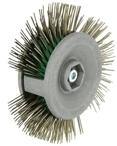

I've had good luck with a wire brush in my drill. Just cleaned out the whole cabin headliner of the Carver in about an hour. It won't grind smooth like sand paper on a disk if you are worried about the weave of the fiberglass (like I have)
Throw away whatever shirt and pants you wear whilst doing this and for sure don't forget and throw them in with the rest of your favorite shirts and pants into the washer.
this is what I have.
