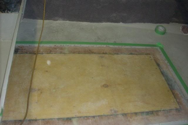

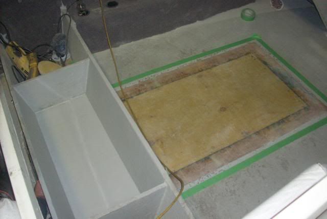

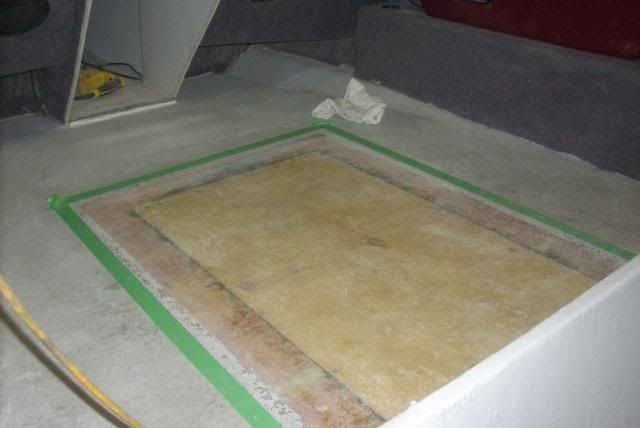

this is a pic of a replacement after it was done....i typed a whole how to last night.....but when i hit send....it went poof and was gone !
