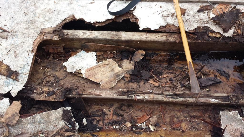

Tomorrow I'm going to start ripping out the floor. I'll post pics and show what's going on. Also I'll drill the transom too

ok I found out its a15 ft 1967 Wellcraft, that's all I know. I started tearing out he floor and found out it only has 3 stringers
Also the sides of the deck sets on a fiberglass ledge that is formed with the hull. whats the best way to cut out the old deck seems like a sawzaw is out.

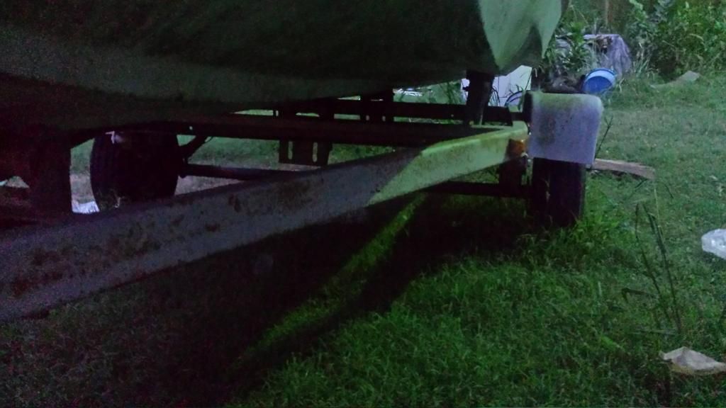

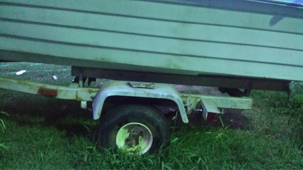

You need to take multiple measurements of the the interior of the hull prior to removing the cap. Across the beam and to of Gunwales to floor height. Once the Cap is removed you can use nylon straps to maintain the shape of the hull somewhat. Is the trailer a bunk trailer or a roller trailer? If it's a bunk you could leave it on the trailer and add some additional supports. It all depends on how the trailer fits the hull. Pics will help us to help you.
Woodonglass
Dec 29, 2009
25,929
Yup, it's a bunk trailer but we'll need to determine where the the bunks are and their length so we can help you with placement of additional supports. Sometimes it's actually easier to remove it from the trailer and build a cradle for it.
