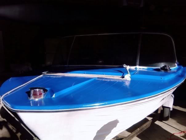

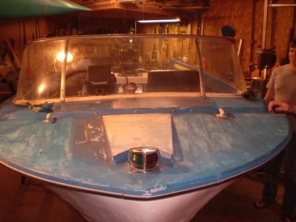

That MFG you have looks almost identical to my buddies boat...I'll have to show him what you did with yours-:cool:
With his, we ended up re-painting the blue for appearances sake, we couldn't do anything with the gelcoat, since it had been sanded some by the previous owner.
Here's what it looked like before and after the painting...
It isn't the best paint job-but it sure looks a lot better than it did. Since my gelcoat is in a better condition than his was, I'm hoping it can just be restored and get a decent shine/color.

Wow! Nice job fixing it up. It does look like an MFG. Maybe a Westfield or Edinboro. Although the lump in the bow deck looks like an owner add-on. Check with fiberglassics.com after they get their site reorganized. They are working on it now, but your friend can browse some old sales brochures from the 60's and 70's that should identify it if it is an MFG.
