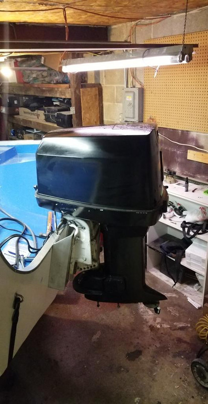

Ok fellas, shes hung back up with T-H marine jack plate. Just waiting on a few parts to put lower back on. Should happen tomorrow and then maybe a test run on Monday.

Yeah guys I went with the fixed mount for now. I thought about it and decided this would be best for the time being. I measured 2 times before picking a height on the motor bracket and pretty sure it should be even with keel or slightly above. At work now but taking off in 2 hours to finish maintenance and hook up controls. If there's daylight you may just see her on the water and get some performance stats *fingers crossed*

The set back is minimal with that plate so being even or 1/2" up should do just fine.

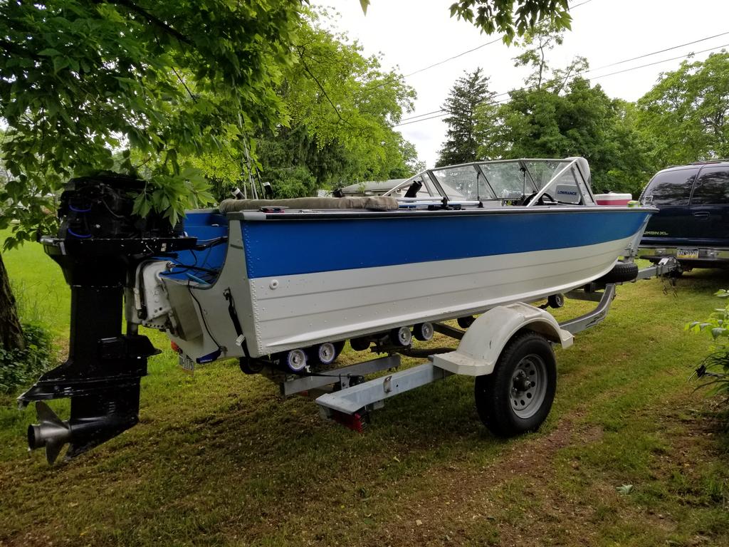

Well guys I did have her out cruising Monday. Not all the expected results but still ran ok. Need to come up 2 holes on mount. Fixed up all the tilt and trim wiring and relays Thursday, installed new controls and cables Friday.
Took out Monday. Maxed out at 5400 and 41mph. Think there's too much drag. Sputtered a little after running for about 20 min. Probably raise her up and clean the carbs next and test again.

Careful raising the motor up more, where is the AV plate at in relation to the bottom?
What year is the 140, if like my Merc 140 it could be prop rated which could drop you 10% in HP or more and anything over 40 MPH takes a lot of power in these boats.

Watermann thinking I have it lined up perfect now. It is a 1990 Johnson 140 V4. I'll keep squeezing anyway I can.

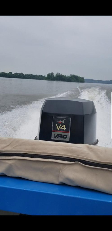

Carb rebuild revealed portside bottom cylinder #4 high speed jet clogged. Don't know how much more oomph that will give me but feels good knowing there all clean as a whistle now.

Man those Loopers sure sound good, love that crackle

That rude sure sounds sweet. You should tell a big difference from running on 3 cyl to 4cyl now..

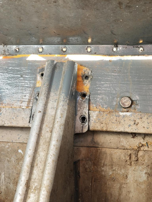

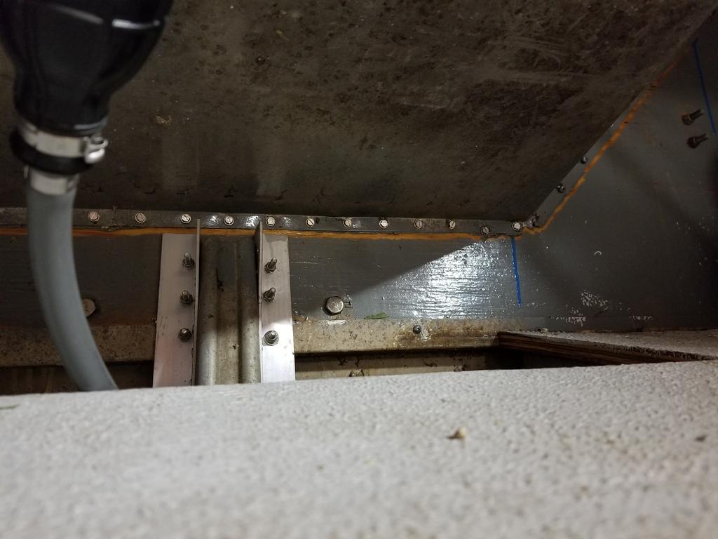

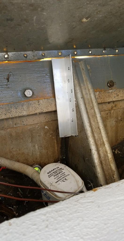

Thanks for stopping by guys. 140 + jack plate ate my knee brace. I reinforced with 1/8" angle on both sides like most everyone else here. Seems a lot more solid. Well see I guess lol
before
Middle
after

Did you get that motor toter too, that would help out keeping the stress off.
