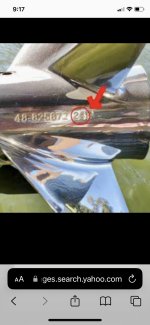

Hey how do i identify my prop in order to buy a spare (or make current one a spare)
That old Mercury
Oct 12, 2023
150
The prop information will be stamped into it.
I am not close to my motor so i found a pic on the internet showing how it is stamped .
I have saw some stamped on either end of the propellor so you may have to remove it . If its not visible on the outside.
