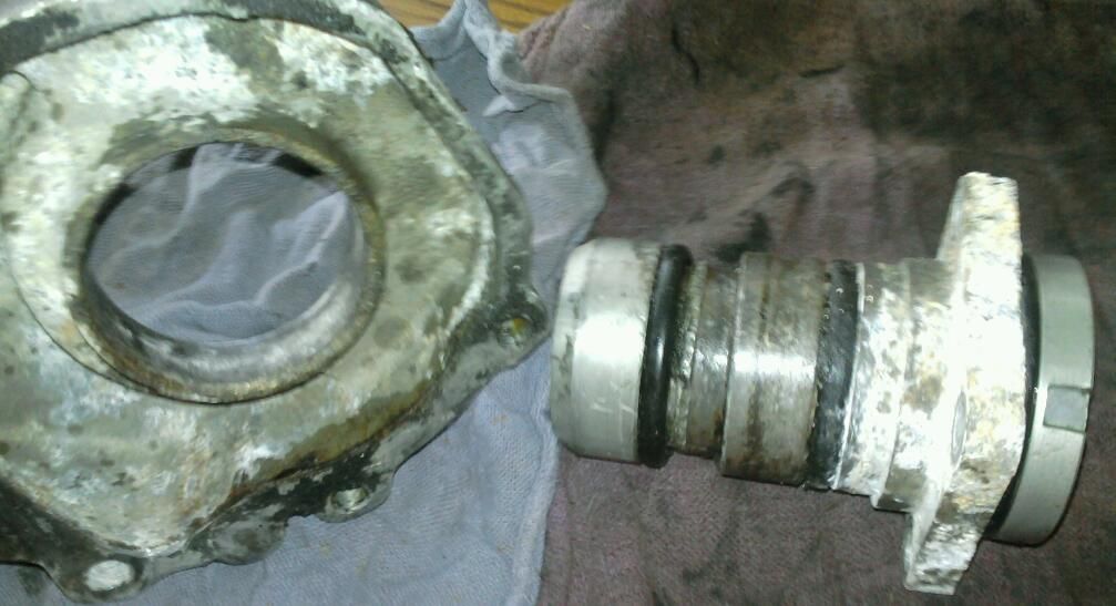

Boats-A-lots
Jul 22, 2012
366
Re: Shift rod over looked for shifting problems.
Here are my ugly parts. Since the water housing looks so beat the crap now, for the $48 bucks, I'm going to get a new on of those too.
PS.. I told my wife if she weighed 160 instead of 106, we would have got that off sooner! :)
