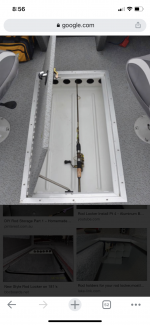

Hey guys any of you have a
rod locker the centre floor of your 16 foot super sport?
My boat is gutted to the gills. To save me a trip to storage to pull out my sleeper seats etc.,im hoping I could get a rough width between the seats. I don’t want it to be too crowded but I also want the rod locker to be useable for more than three rods sort of thing. Maybe five or six.
Wondering if I can get away with a 12 or 14 inch wide door.
if anybody has a rod/ski locker or has built one, some ideas and what not to do‘s would be greatly welcome

Mine came with a ski locker in the center. I took it out and opted for a under floor fuel tank. The stringers are what you have to work between. According to my fuel tank planes, I accounted for 17.55 inches in width to sit between the stringers.

Thanks, agreed. Do you recall the width of your locker?
I’m not sure if there’s enough depth for a pair with reels attached except for maybe in the centre of the V (planning a V shape pan inside to shadow the hull shape)
Towards the outsides the pan can only be 3-3.5” or so. Ok for spare rods without reels maybe.
I’m wondering if the efforts and expense are worth doing.

Would have loved to have a ski locker in mine, but seemed like a lot of work to make it look nice and original. As far as measurements go, it seems like it depends which shift was working that day/year. In my ‘79, the stern is 18.5” wide between the center stringers, and in the bow its 18”. They are also offset by a 1/2” lol. If you build it measure yours first - looks like @SHSU and I have a full inch difference between our measurements. Would be nice to store rods though - i cut holes in my SW prior to finding this site or thinking about the future build. Will be storing mine above deck in rod holders which is not as ideal when the boats full of people for fun after fishing.

I think I’m going to keep my compartment as forward as possible so there’s more V depth for reels. I will have to pull rods apart to double them, then store them that way. Shorter pvc tubes and shorter “box”. Maybe keep the total assembly down to 5 1/2 feet long. I’m still trying to keep a good amount of flotation foam under the floor at the back. It’s going to be a fairly shallow locker though I think like the picture attached. But more of a V bottom
I am going to do a long, curved PVC tube or two on the passenger side. So I can put full length rods away in the side cubby.
I really don’t want rods laying on the floor or piled in the bow. Or sticking up all over the place. And the net stuffed beside the seat drives me crazy too. I haven’t figured out a solution for the net yet.
I will probably make a filler board for covering up the splashwell. I’ll put little returns on three sides. I could lay the net there. I did a mock up and quite like the idea. Might even have a cushion made to fit that space and keep the net under it.

I think I can make enough room for six rods wide. Maybe the outer tubes will be for rods without reels on them - spares.
I think I can get it to work with my 6’6” rods fully extended. Anything longer will have to be doubled over. I’ve got a 9 foot rod that I’m going to store full length on the side in a curved tube under the gunnel.

Mine were wavy too. I just accounted for a 1/4 of slop on each side. So that gets us around 18 inches which is what @Moserkr had as well.
For depth, I think it was closer to 4 - 4 1/2. If you look at the stringers they got taller the closer you get to the Bow. Depending on the reel, you should be able to fit it in that space no issue.
Since I went the under deck fuel route I didn't have the room for a rod locker. I instead ran ours along the sides. Mostly out of the way, so its functional.

Yes, you’re right the stringers do get taller towards the bow. I’m planning on keeping the compartment door back so it’s swing isn’t between the helms. I was planning a drop in deck over the bow footwell area, but I might build a drop in live well to fill that space.
