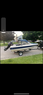

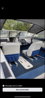

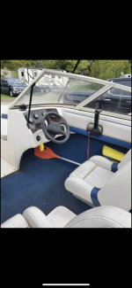

Tonight I dragged home a small fiberglass bow rider with a damaged 4stroke merc on it. Going to toss one of my 2 strokes on the back and use it at my trailer for the season. This will allow me to continue taking my time with the SS. And if I like and keep the glass boat for the trailer, the SS will go back to be my garage kept travel boat as originally planned.
Hopefully I can fix or rebuild the 4 stroke. I want to clean up my act

That's a really clean little glasser! We owned a Tempest 165 with Merc 60hp 2-stroker briefly. It was a fun little boat, but didn't handle well with more than 3 people in it. Lots of power to get on plane, but it felt unstable in turns which was disconcerting. Maybe it was my lack of experience, but the SS16 clone feels much nicer with 5-6 people than that Tempest did with 3-4.
That'll take the pressure off your project, so you don't rush it like I'm doing!

Thanks R. It’s on the small side but we’re on a small lake. The photos look exceptional but it’s a little more long in the tooth than it appears. I’m hoping some scrubbing will revive the bench upholstery. The cover back there has been missing and it’s a bit grotty. But this boat might be all we need at the trailer once I add a Bimini. Mrs. Admiral still loves the SS and is looking forward to it being done. I totally agree with you and her, they are pretty stable boats
