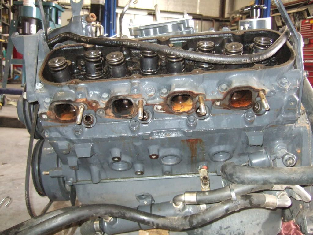

I don't need new exhaust manifolds, they will be fine after they are in the cabinet washer. The engine is out. Pics here.
http://s246.photobucket.com/albums/gg114/poofdirt/Engine out/
I am wooped. Going back to buddies tomorrow only to put it on the engine stand and get the boat out of his shop. I took me 5 hours of trying to contort by body to get to everything I had to unhook. The only help was my buddy running the forklift.

Hmm.....I don't always like to be the guy with the bad news, but I think you may have a cracked block! (between and above the the two rear core plugs....)

No problem, Next door neighbor has a fresh long block for 200 bucks. There is no bad news, it's all easily solved. I am aware of the difference between marine and street engines.

You are one lucky dude! Just make sure that that it's a truck engine, use your current camshaft or plan on obtaining the right camshaft for it.
With all that water in the exhaust ports and a cracked block, I would expect the manifolds to be cracked too. I would not trust them if they're really rusty. They should last a good long time if they were only ran in Mead, but I know you get pretty cold temps there............ Your risers/elbows might be ok ....the surfaces might need cleaning up though.....
