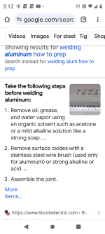

3 welders told me this....one a professional prop guy who is a close friend, my machine shop buddy who's an expert welder and a professional welder who works in the marine fishing industry and has 110 guys welding on his staff. No grinders.
That warning is a kin to the "do not use Teflon tape" on fuel connections.
Its a competency/skill issue, not an application problem
Unfortunately, "Professional" means nothing anymore other than you're paid to do a job anymore. Most are what we called "rod burners" back in the day.
The state of the Trades industry is abominable. Nine out of ten fabrication shops I interview to qualify to do fabrication work for our company don't have a single professionally trained or certified welder on staff.
The sad part is that most of the tricks of the trade (fit and finishing) that where pasted down to me during my apprenticeship have long since been forgotten. Have only met few who even know what a spark test is, let alone be able to pass one.
I'll get off my soap box now.
No grinders......lol
All tradesman above are old school guys. Prop guy (still a hand banger) is 65.....machine shop guy is 70 and it's his grandfather's old shop and my maritime welder buddy 63.
They all said the same thing. Stainless steel wire brush.
I'm sticking with them thanks
