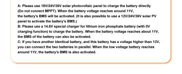

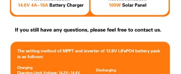

This is from the product page, it talks about 11.6 being 'disconnected'? Also, recommends 4 to 10A charger.
redneck joe
Mar 18, 2009
14,471
Min are in parallel but why does it say to use solar charger to activate BMS

What they're telling you but not telling you is that using a battery charger that can supply a constant voltage at or above 14.6 V is best, as this will activate the battery's built-in management system which will implement the "smarts" needed to properly charge the battery. I'd say that the supply needs to be capable of a few amps at that voltage at least. And yes, if you allowed the battery to go below it's minimum, it will be pretty much useless going forward. Lithium batteries do not like going below a threshold voltage for much of a length of time without being damaged.

I was told that these batteries need more than a trickle charger when the battery is low ( below 50%). Once the battery is charged a small or trickle charger will keep it full. My mfgr recomended a 20 amp 14.6 volt charger for my LifePo4 140 ah battery and it works great and it is quick. These batteries do not like me a long slow drawn out charge rate.

But... it sounds like they bms will shut it off to save it? Then reactivate when 11.6 v is achieved?

The BMS takes a wide range of input voltage and makes it work. It will also limit the current to only allow what it is programmed for, so you won't have to worry about maximum current capability of the supply.
