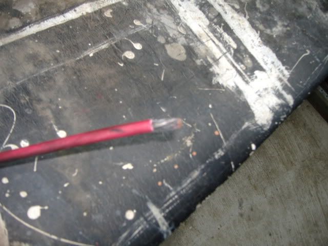

Even good quality fully tinned marine wire suffers...
Pacer Marine 6GA from a 12 year old Proline. Note the dreaded "black" on the bare end...corrosion...
