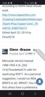

I have what I have assumed is a 92 4.3LX mercruiser V6. Serial # shows D828755 or might be D626755 (I'll try to attach a pic). I have been using service manual 7 which says it covers serial number B775130 -F000000. The service manual lists Champion RV15YC4, but other sources for the same serial number range list Champion RV9YC for NGK BR6FS. Physically those two spark plugs are different lengths. Am I using the wrong service manual? I know I could go pull a spark plug, but havent had a chance to get to storage and want to make sure I have everything to get ready for summer.. TIA for the helpScreenshot_20210426-155144_Gallery.jpg

I compared the two different plugs the threaded part/spark part appear to be se same length and thread size, the ceramic and end is where one is slightly longer than the other. Is it fair to assume that if the reach and diameter are the same then the spark plugs are comparable and the overall length is cosmetic? Also gap of 0.035 inches is the correct gap. The Champion catalog at west marine listed 0.040 inches.

Misread spec chart, spark plug hex size is 5/8", but reach is 12.3mm and and on the champion I believe it's 11.2mm. Is reach the part the goes into the engine block? More curious about that 1 mm difference.

Bought new AC Delcos. Compared to the NGKs the reach appears the same, but AC Delco overall body is longer. Will probably replace like for like.
