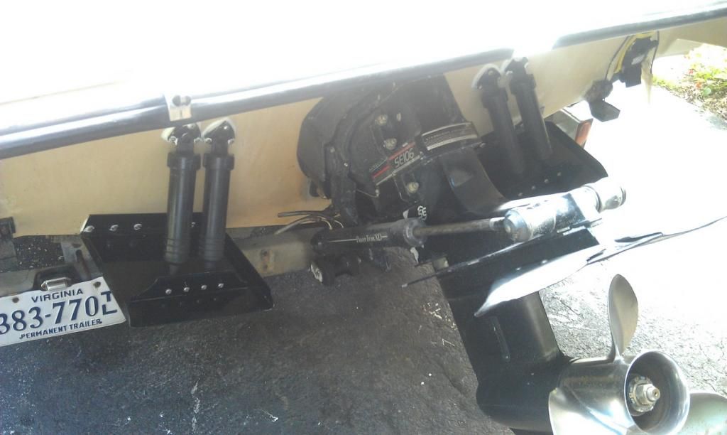

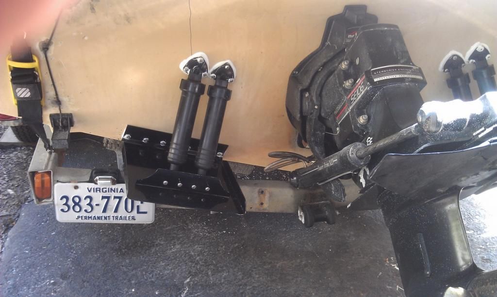

Well here are the tabs, I have installed them as far out from the center line as I could without invading space on the other side of the transom I can't access.
It was extremely tedious and messy, marine epoxy and 5200 are a pain to work with. I haven't installed the hydraulics or wiring, I just got them bolted on. I know that's the hard part so I wanted to do it first.

Took it out Saturday, LOVE the tabs, boat hops right up on plane now even with the whale tail removed.
I still got my 50mph top speed so I'm quite happy.
It's amazing how all the Bennett stuff just worked even though it had been sitting in a barn for over a year and had been on another boat for some time before that.

So, no speed increase from the tabs? Glad it has worked out for getting the boat up on plane.
