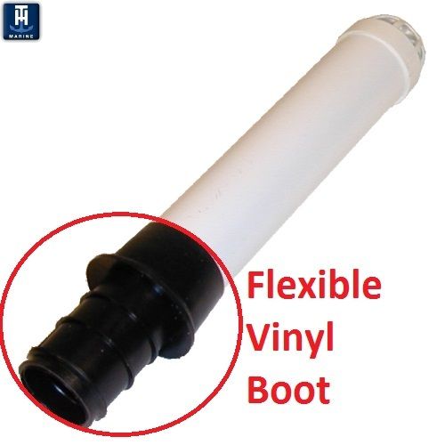

Thanks Scott for the info. But my drain doesn't use the push in stand pipe but the new threaded design that they are now offering. Seems folks were having problems with the push in type with the "O" rings were getting loose and falling out, draining their live wells without them noticing it and the fish were dying because of that.
Unfortunately, you've been misinformed. There are no "O" rings in the "push in" assembly. The stand pipe for the push in assembly has a flexible vinyl boot that pushes into 1-1/8" diameter thru hull fitting.
This assembly is secure and is OEM on just about every new boat with a livewell that I've seen. I have this assembly in the livewell and baitwell on my Tracker. Just push the standpipe in to fill a well and pull it out to drain, easy.
The push in assembly eliminates the need to screw in and screw out the standpipe, it also eliminates the possibility of the standpipe breaking off at the threaded connection leaving the threaded end of the pipe broken off in the coupling.
52,349
Or you can buy the screw in ones that fit for $10
