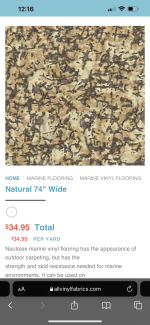

Wood will def cut down significantly on cost. I plan on priming and base coating everything inside, then covering top of gunnels, floor, platform, and rear Box/seat with whatever decking material i use.
Still a ways off, obviously, but going to attempt this camp pattern, and for cost and durability use this flooring cover

Aluminum floors would be pricey and even .125 would bow as you walk on it. Its doable but not really worth it vs wood. Plenty of ways to seal wood too and it will last quite a while, maybe 20 years?, especially if you cover with vinyl on top of the seal.
Camo pattern looks good! Great part about a duck boat is you can beat it up and you will never notice!!
