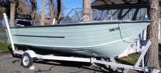

My 18 Starcraft Holiday !
Fishon125
Mar 15, 2022
16
Yes, it's a 1965. The interior is almost pristine, too! Original seats without a scuff or tear !
