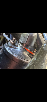

After poking around some and having someone to help me crank it over and check for spark I rechecked the spark at the spark plug wire and I will get one spark from the plug at the first initial crank and it’s gone.
From there I just happened to see out of the corner of my eye the coil arching out. It was coming from the postive wire to the center of the coil. I removed the coil and for whatever reason I had it upside down and there was liquid leaking from the center of it.
Do I just replace the coil and see what happens? Or did something further down the line fail and cause the coil to fail?
Ayuh,...... That's where I'd start,.....

Installed the new coil tonight and the boat fired up instantly. Didn’t have to pump the throttle or anything. With the boat in neutral I gave it a couple revs and there was no hesitation or anything. Revved smoothly.
Now my mind is wondering do I leave well enough alone? Or do I replace/upgrade the ignition system while I’m in there already
