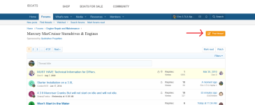

Welcome... Start your own thread with your question instead of at the end of this one that's 11 years old. These old threads are for reference only, unless you are the original poster, and posting in one will get it closed for further replies.
Screenshot 2025-07-12 at 13-15-07 Mercury MerCruiser Sterndrives & Engines Boating Forum - ibo...png
