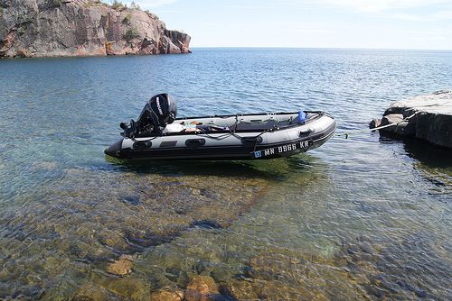

Where are you storing this thing and how do you plan to transport it? Without a trailer you will get very tired fast of the set up time needed. But having said that I don't use a trailer and only use my 12.5' (JP Marine) in Lake Superior and am two weeks away from a 9 day trip in the Apostle Islands.

Sweet set up. That boat is definately going on my list.
