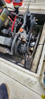

Ok... new thought. Engine temp.
My gauge has always shown 160 and never noticed any signs of overheating but...
The largest hose from the front is always very hot and the other three are cool (on cold hose water).
I removed the big one and ran the engine for a few seconds and cold water is coming out of the thermostat. Why would this big hose be so hot. The water inside it is almost scalding when i removed it. Could there be a blockage somewhere?
Exhaust manifolds are always cool. Water is exiting the rear of the out drive when running.

If you ran the engine as it's pictured and noted cold water exiting the large barb hole for the circulating pump hose that's normal
You're seeing the raw water supply from the pump in the drive. Thermostat controls water flow exiting the engine block and would only release hot water to exit via the exhaust cooling hoses/system
The circ pump hose is hot because it's connected to the pump that is circulating hot water through the block. The raw water cannot overcome the flow created by the hot water so it exits through the exhaust. Only when the thermostat opens does the raw water enter the block through the hose due to the difference in block pressure
Thank you, i pulled and tested the thermostat and it checked out. Kinda an odd system compared to a car, had to pull out the manual to figure out the flow.

It's used as a mixing valve to mix block circuit with the constant flow to exhaust
