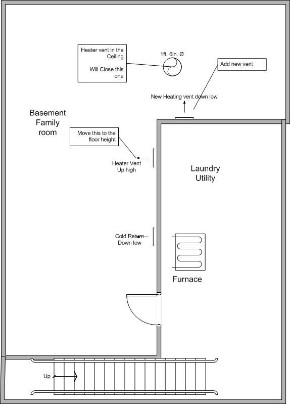

rogerwa
Nov 29, 2000
2,339
Re: Supplemental basement heating
Here is a pic of the basement - roughly.. I have highlighted possible changes.
Tim Frank
Jul 29, 2008
5,351
Problem is that your duct outlets will all still be in the middle of the footprint.
The best place for the heat ducts would be on the outside walls
I'd be inclined to add a new heat duct on the outside wall.across from the furnace...that should be OK with the way your joists likely run. Leave the existing ones.
It is not the end of the world if the heat ducts are up top, just makes it imperative to ensure circulation by extended fan operation and locate cold air returns low, and as far from hot airs as is practical.
Are there two existing heat outlets and are they both ducted, or is the one on the wall just a grill?
Is that cold air return just a wall grate between the two rooms? or is it ducted to the furnace?
If not, run a 6" duct from your cold air plenum down to that grate.
Is it a solid ceiling or suspended ceiling c/w removable tile panels?
rogerwa
Nov 29, 2000
2,339
I do not have much choice about putting them on the outside walls as there is not space between the concrete and the wall, or not much, even if I could snake the feed through the joists. My only choic in that scenario would be to put them on the celing.
I could put one under the staircase as I have access behind there.
The ceiling is drywall and is attached directly to the joists..
All vents or returns are ducted..
Tim Frank
Jul 29, 2008
5,351
Under the stairs would be a pretty good location,
AND maybe relocate the proposed new one to the corner where the utility room wall meets the outside wall,
AND don't yet move the heat duct down to floor level, it is probably better to keep it as far from the cold air return as possible.
aspeck
May 29, 2003
19,572
I agree with Tim on his last thoughts for duct placement. Should provide good air movement. Make sure your return duct is large enough to handle the volume of air from the vent ducts. It needs to be sized small enough so there is some pressure build up for air flow, but large enough so the air does flow. There are formulas for this. Also, depending on how the upstairs is ducted, you need to be careful you are not robbing air for there. There is a science to this, and I am not that scientist.
Tim Frank
Jul 29, 2008
5,351
So, quick review....
1) Fan on 24/7 is probably your cheapest and maybe most effective single step. If you have a fairly accurate thermometer, you might take temp readings at floor level, 1/2 way to ceiling, and at ceiling level in a couple of spots before you start. Allow a few days to assss results.2) Tweak the ductwork. Keep taking temp readings and see how you have progressed.
3) Be sure that the new ducts have internal dampers so that they can be balanced or at least tuned a bit. You did say that closing outlets did not have any effect....but you might want to try again after you are running the fan constantly.
