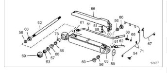

  • Genuine Volvo Penta Outdrive Trim Tilt Bushing Part Number 3853423
  • Fits Volvo Penta DP-S, DP-SM, SX-C, SX-M sterndrives
  • Set includes 4 Bushings
  • Factory OEM Original Equipment
there are plastic bushings that slip into the cylinder ends .Need to look up transom housing in the vp schematics1661704296162.png

The plastic bushing is to be inserted in the outdrive housing, not the trim cylinder.

I know of the plastic bushing that goes in the gimbal. I was refering to the brass bushing that is in the rear of the cylinder.
Nope, look it up in the SM. Maybe on the newer rams but the older style go in the ends of the rams also
Just saw the video, your ram is different then the job I just did .

A bit puzzling, the earlier Cobra drives had the nylon bushings.

I can only assume that they have been modified by someone. They look like the VP cylinders for the SX & DP outdrives from 1995 to 2005. I think you might be able to find a brass bushing to fit inside that has a 19mm or 3/4" ID to suit the pivot pins. Or perhaps the nylon bushings that are in the outdrive might just fit ie. part number Bushing 3853423 and Grommet 3853424.
