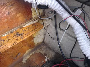

This is front right I dont know whats going on here it looks like theres patched with no fiberglass and I guess some of the it is hanging down from the floor. Also the latteral support on the floor looks like it hasnt been glassed in.

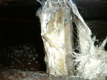

This is the same untreated piece that looks to be pulling out of the stinger.

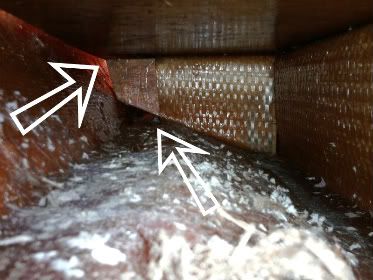

This is to the stern and this piece looks to be in the worst shape. Its actually bent, its hard to see in the photo.
I'll have more pictures of the floor in better light later. But after looking at this I think the floor needs to come up...

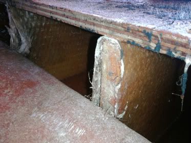

Today we removed the wall that seperates the cuddy from the rest of boat. Also got the rest of the carpet out. Got a good look at the stringers
I dont know if this floor is original, it doesnt look like theres any mat put down on the plywood it just looks like resin on it. Should these gaps be here? I also havent found any foam.

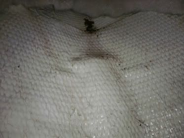

Im also wondering what this white is. Is it just paint to make it look pretty or is it functional? Its on the transom and the bow.

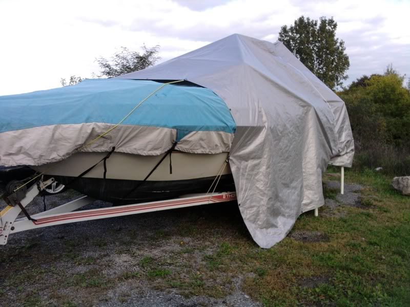

Didnt get any work down on the boat today but I did build myself a garage for it so I dont freeze my biscuits off this winter while working on it. PVC pipe and tarps... yea not redneck at all. My boat is parked in the over flow lot for my apartment complex across from my garage. So I have 130ft of extension cord running out to it. People look at me funny for some reason :cool:

I have a 88 Daytona 260 and what your looking at isnt too far off from what I had to deal with. I would say that finding things that seem odd are actually normal for this boat company.

It might just be me but Ive seen alot worse. In fact it dosnt look to bad at all. Maybe the pics are better than damage. but it looks dry.

It is dry, but the floor has a good bit of give to it. Im not sure how strong the structure underneath is. And like I said, I still havent found foam...

Re: Thompson resto
either that boat was redone without foam to save money or the foam is all in the sides of the boat. if the floor supports and transom are dry then I would beef them up and that will help with the soft floor. imho

Re: Thompson resto
I second above, my first impression looks dry and redone once, but not very well. The floor sag your feeling is the suports pulling out as you mentioned.
Since you have the garage built yank the floor, treat endgrain, build up supports, reglass, foam if you wish. You have been using it all summer, was it noisy? did it float? By some cheap ply to make a template or if you carfuly remove existing floor use it for template. Then get exterior grade ply (same glue as marine ply and the stuff your pulling is ext g) treat end grain resin both sides 2x, (ss)screw it, glue it, glass it, sand paint it, Done :D

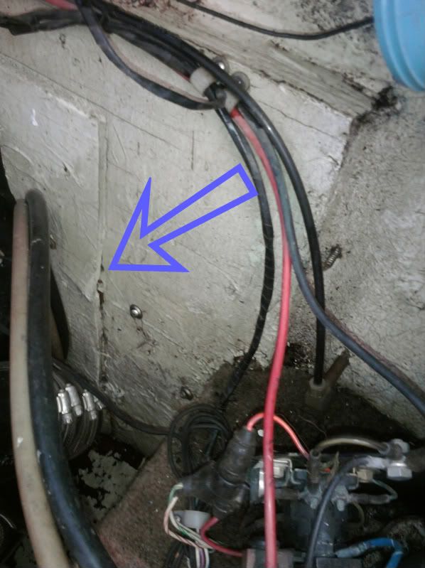

So in more of my deconstruction, I found something else odd. On the transom just to the right of the drive theres this lifted area. Theres also two screws near there (something might have been mouted there?). I dont know if it was ment to be like that or if its a problem. Has anyone ever seen anything like this or have any ideas?

That whole spot looks to me like a patch of some sort. Alot of boats had problems from that era of de-laminating. Looks as if someone tried to patch for that problem. I could be wrong. I would drill wholes and check the condition of the shavings.
