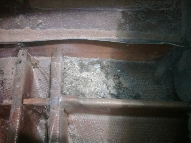

That whole spot looks to me like a patch of some sort. Alot of boats had problems from that era of de-laminating. Looks as if someone tried to patch for that problem. I could be wrong. I would drill wholes and check the condition of the shavings.
Looks like we have our work cut out for us. The motor mount as well as the stringers look like they aren't original and are rotted... The transom also looks like it was redone by the same person. Any suggestions on how to tackle this? Any special tools I will need?

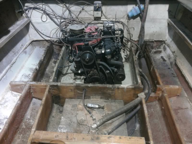

Here what it looked like under the floor...
notice the untreated 2x4s and the nice rusty nails used to hold the floor down
There was about 2in gap between the plywood and the hull of the boat. It was just fiberglass
Are the stingers supposed to go all the way to the edge? or stop like this

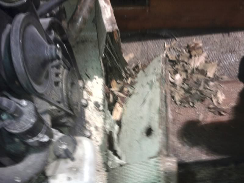

Heres where the real fun is starting. The engine mount doesnt look to be in good shape either. So once the engine is out we'll be able to check the transom... Hopefully its in good shape but if its not theres no sense in doing everything else and not that...

read the thread.....actually....it all looks great under the deck.....stringers good.....dont worry about no foam....you just saved your self a step....its a real pita to remove.
the patch on the back of the transom could be factory.... but you have to pull the motor to get at the motor mount that is rotten....so when the motor is out, thats when you do your core samples on the transom....if its good...leave it....just seal any hole that is drilled into the transom.
