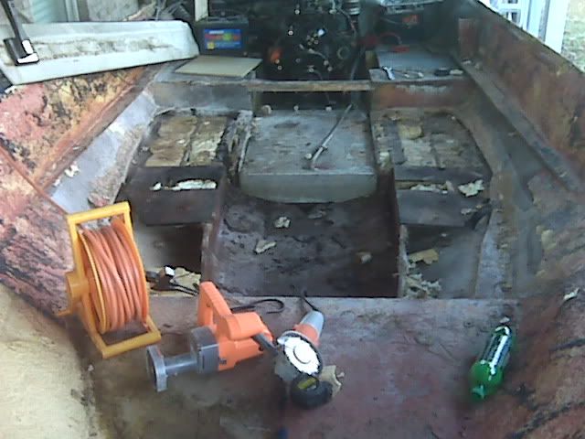

I get get a few hours on the boat this weekend. I even got to try out my new tools. The first was the flush cut saw. worked very well once I new were to cut. I could get very close to the edge leaving less to grind.
The second tool was the chainsaw on a wheel, the jury is still out on this one.
NOW for some pic's.
This is when I first got the main deck off.
Gas tank removed.
The stringer in the middle gone, no tools required.:eek:

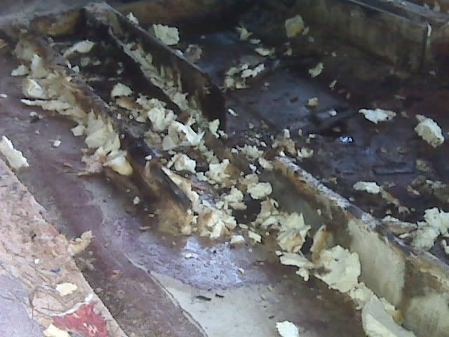

This may be rushing things a little but, I'm looking at ways to correct a major flaw in the design (as I see it). If you look at the picture below you will notice a thin area of foam. There is only a couple of inches between the two stringers or one stringer and one bulkhead. I know I will have trouble getting glass down between the two members. Any suggestions?
One more thing, early in my thread Drewpster ask me if I was pulling the engine, I can now answer that with a definite yes.
The next time I'm home, about 2 weeks, the Stern drive and engine will be coming out. I hope.:eek:
The left side is the stringer, the right side is the bulkhead and they both go all the way back to the transom.

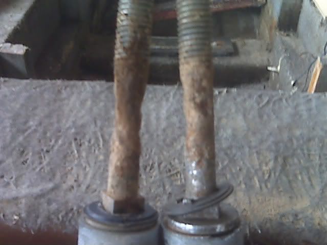

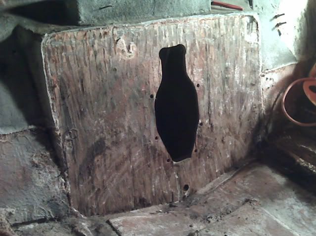

The lower portion of transom, the part I couldn't see was rotten, I pushed a screw driver all the down to the drain with out even trying.:eek:
So System-f, I will be replacing the transom after all. I guess I'm now, I am past lowkee's 10 steps of denial.:p
I do have some good news, My transom is a stepped transom and that portion is only 25" H X 33" W. Everything but the bottom is standing proud and easy to get to. Plus it is small enough to fit in my vacuum press. :cool:
This was my first clue, I had a problem.
Then I found this. :( View of the bottom of transom hole.
Sorry for the blurry Pic's. I'll work on that.

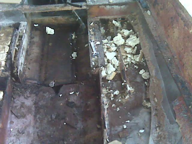

I did manage to get the top cut off one of the boxes on side of the engine compartment. Guess what I found in there? yep, more foam. I got enough out of it to fill a couple garbage bags.
The foam was dry at least.
