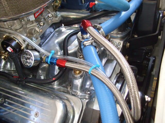

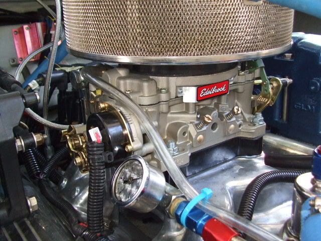

Like this?

Wasn't sure if AN line and fittings were Coast Guard approved? Do you use this in salt water? looks like it is holding up well to the elements.
Fresh water only.
Those pics were take after almost 2 full season of running.
OK, now for the bad part. AN hose and fitting are not USCG approved.
But.....I have been inspected several times by the USCG and they are unofficially fine with it, a lot of us go fast types run it and they have never said anything about it. If fact, we were joking about how AN is approved for use on the SR-71 Blackbird and for some reason not USCG approved and as far as they are concerned it is far safer. They always comment on how good it looks too.
I also have had the state water cops inspect it and they always say the same thing...dam that looks nice!.....and they are good with it too.

Let me add this....
Last Spring when we were summerizing, the engine would not fire off. I had just put a new Sierra fuel filter on the boat (I change fuel filters in the spring, run it a few hours, then change again to soak up off season water).
I watched the fuel pressure gauge and saw the pump was not picking up fuel. I took the filter back off and saw the gasket was FUBARED from the factory...wasn't flat and even, pump was sucking air through it.
I swapped filters and cranked and in a couple revolutions I had fuel pressure. The inline guage saved a lot of diagnositics.
BTW, I not longer use Sierra fuel filters once my stock was used up.
I also have an oil pressure gauge mounted on the remote oil filter assembly. I like the ability to watch the oil pressure when I am back in engine compartment....I can see it come right up as the engine cranks.
