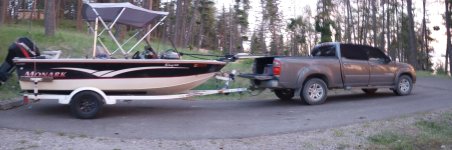

There is nothing near me. lol. I'm in pretty rural Montana. Hence why I was going 80mph. 😆 But your concerns are valid.
I have an email in with a couple companies to check pricing.
I'm not sure what weight the axle is rated at. The trailer itself is 400lbs. The boat is about 1000. and the motor I think is 300. It's not that big.

I’m glad it wasn’t worse than it was.
400.00 is much less than the thousands of insurance costs it would have been if the boat took a dump at 80 mph. It’s a relatively easy job to replace the axel. No real special tools required either. Glad you and your rig survived.
As others said , replace it.
Good luck. Keep us posted on your progress.
