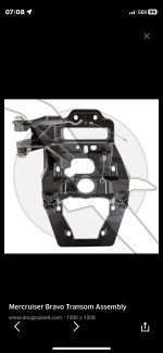

Hello I have 1989 Mercedes 5.7 when looking at the transom the top right plate has about4 inch ground wire all metal.id like to know where the other end screws into into for the grounding. I can’t Seem to find any screw holes

Top goes to the steering arm. Bottom right connects to the engine. There’s a stud on the coupler housing

Ok I knew the bottom but couldn’t find the top will look when I get home thank you

the screw hole is in the top of the steering arm. If you are missing the screw it’s probably a 6-32. You will want stainless
