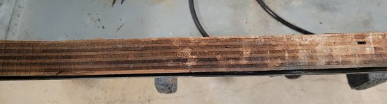

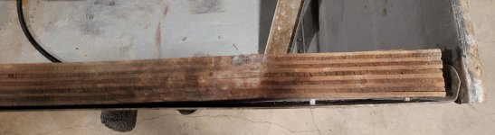

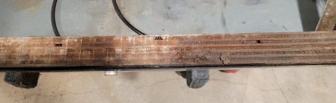

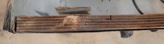

Scott is smarter than me and the pic ain't great but that wood does not look healthy. For the small dollars to replace, start there.

I think the boat is actually from the mid 90s. The reason I posted is because even with the 5hp outboard, I was getting a lot of transom flex. I don't want to replace the wood in the same configuration and end up with the same transom flex. That's why I was asking about a transom plate.Actually that plywood doesn't look as bad as a lot I have seen. I will assume that the Boat was from the 70s, maybe early 80s, so 45+ years.
Another piece of Marine Plywood, will probably outlast most of us on this Board
