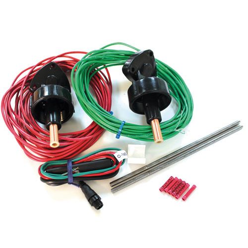

So if I just replace my euro style switch with the eic5000 switch, is that pretty much all I do? I just don't want to have to do any work on the actuators is all,
Take a look at the link the the instructions I posted http://www.bennetttrimtabs.com/wp-content/uploads/2015/12/EIC5000-Instructions-Online-v121415.pdf
You need to replace the place the tops of the actuators with ones that have sensors in them and run the wires from them into the boat. It's pretty easy.
Read over the instructions and let me know what you think.
