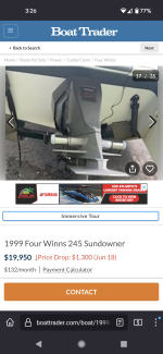

chris032188
Jun 14, 2021
18
I'm not sure if back there is reinforced like a transom is? Does it have to be ? Because I've seen people mount them like it
