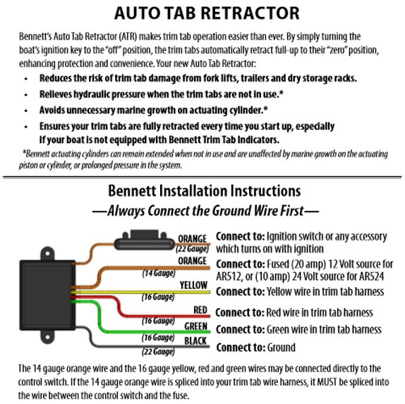

Check up under your dash and see if you have an automatic retractor installed. Here is a picture of one.
Bennett Marine: The world leader in trim tab innovation, quality and service
It may be installed to keep the tabs from being damaged in case they could hit the trailer bunks when down.
Be sure to check all the wiring connections for the switch and power at the helm as well.
If you do have an auto retractor, you might want to disconnect the fuse from the main orange wire and see if that cures your problem.

Don,
Good Info Regarding the Auto Tab Retractor.
That's exactly what it does, retract the Trim Tabs when the ignition is switched off. Instead of the main orange wire, I would suggest removing the fuse or disconnecting the wire on the thin 22 gauge orange wire. It's the trigger that tells the system to retract when the ignition is turned off.
Here is the wiring diagram for the Auto Tab Retractor:

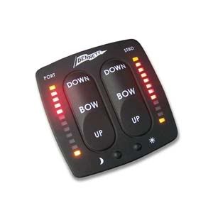

The Auto Tab Retractor is also built into our EIC Electronic Indicator Control shown here:
Just to be sure I am assuming that you do not have this control, but rather two side by side rocker switches. Is that the case?
