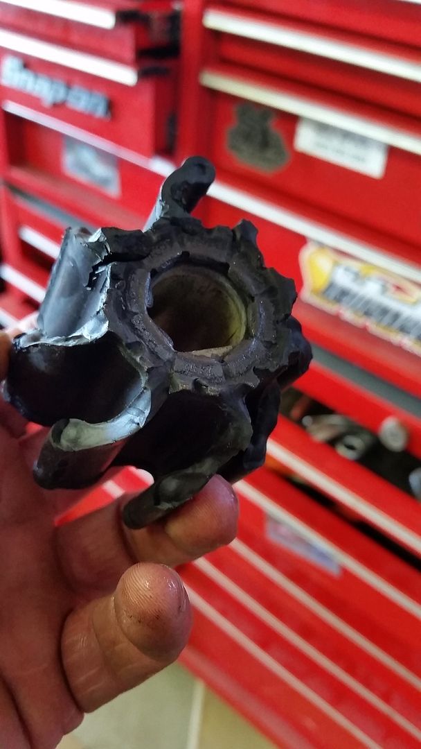

Raw water pump impeller was all torn up (would support the over heating theory)

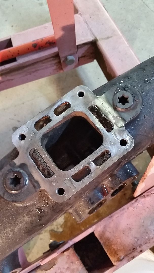

not sure if this testing shows anything or not but water level never went down

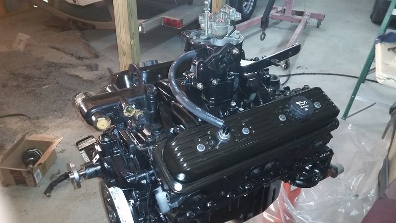

my michiganmotorz engine awaiting my gimble ring to come back so I can install it:)

If it wasn't winterized, you could easily have cracked manifolds. I would at least pressure test them before using them.

Fill the manifolds with acetone. It will leak through cracks water wont. If it was mine I would replace the manifolds for peace of mind.

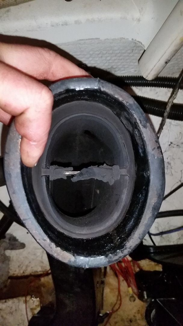

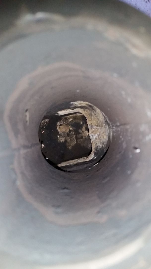

Does this look like it was leaking? This is looking into the riser from where the rubber coupling attaches.

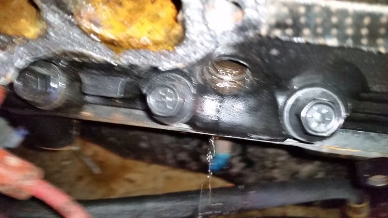

water isn't supposed to come out of the spark plug hole is it? Lol

Back to the original question, " what went wrong?": Easy. The PO neglected the maintenance on the outdrive and the impeller failed and the engine WAY OVERHEATED (evidenced by the burnt up shutters), to the point where it seized, then failed to winterized, block and manifolds cracked and leaked water into the engine. How to prevent reoccurrence? That is easy too. New impeller every couple of years.

He said "milkshake up top" I took that to be on the heads around the rockers, that could just be sludge and condensation. in any case it looks like the impeller failure led to the engine failure.
