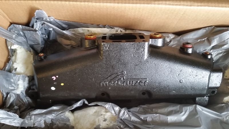

I ended up buying brand new oem mercruiser manifolds and risers. Got them for $650 shipped.

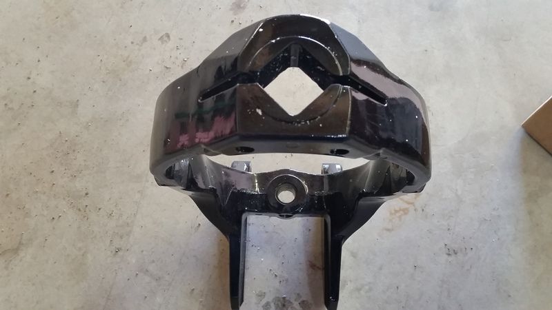

Put my jrmarine repaired gimble ring in, the whole assembly has new seals, pins, bellows and all

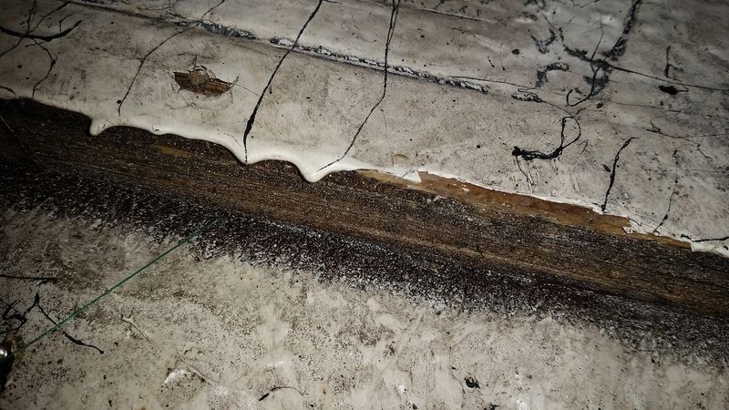

Everything was going good, until I went to torque down the transom plate. Used 25ftlbs as specified. Got to the lower bolts and...crack! Plate cracked. After investigating, I have a soft transom. Great! Rinker failed to use anything to water proof the bottom of the wood. This picture is at the bottom of the bilge looking up. Wtf?!?

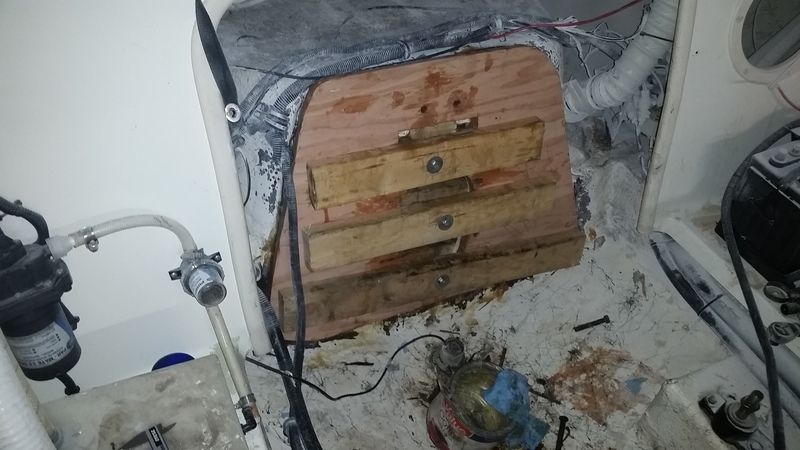

So, got the wood removed. Luckily the wood is just this section. Doesn't go to the stringers.
Made a template of the wood before I took it out. Today's plan is to hunt down some replacement wood and start cutting. Been talking to a place in California for the fiberglass supplies. Hope to have it all back together in a week or so.

Wood is in place, need to finish the fiberglass.

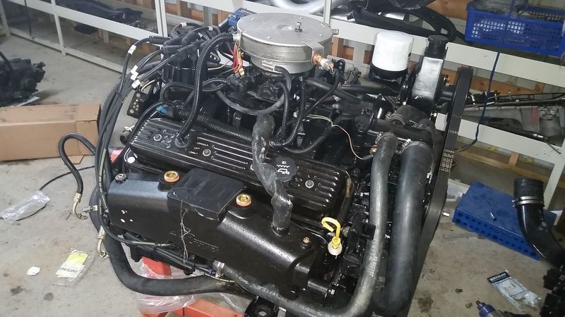

Engine is just waiting for the transom to be completed. New mercruiser manifolds and risers, new quicksilver raw water pump, new engine, new water pump on engine, new tstat, replaced shutter valves, new ngk plugs, new accel 8.8 wires, new dist cap and rotor, all new bellows and seals in the bravo 3, checked for old raw water pump rotor pieces. Hoping to be in the water in a week or two!
