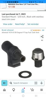

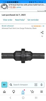

I have used the 30 gallon Craftsman drum shop wt dry vac on the tank. Then i duct taped a section of 5/8" vent hose to the vacuum line..
That got into the corners of this tank.
My petrol supply is rotated regularly. Its a shell station on a state highway. Which on tuesdays has 10cent per gallon price cut.
I just put in 5 gallons. Reset all electrical connections and taped any moving cables..
The vent hose was not looped for the "P" trap effect.
I bought new hose. Then Installed the new vent cap and this fancy anti slosh wizbanger.
I will try to take it out Thorsday ...
Thanks for reading
F

Thanks for teaching me. I will uncoil the hose. s the vent with built in "P" trap and the anti slosh tube sufficient?
F
