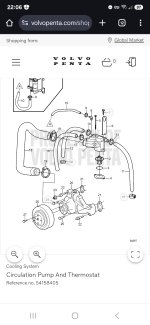

As a preventative measure this year I thought I would change out the thermostats as to the best of my knowledge they've never been done. So I took it apart and then reinstalled thermostats the same way that I took them out at. Then started looking at a diagram and realized that they were upside down (spring down). I have never had any cooling issues and they regularly runs at 160 to 170 ish. Confirmed using a Diacom.
I'm going to reinstall the proper way, with the spring facing up towards the gadget, but anyone understand why I wasn't overheating??

Because they are installed correctly with the spring down. If you install them with the spring up, it WILL overheat. I’m old school, what is a diacom? Or do you mean a diagram?

I'll clarify that it was opposite of this diagram. Spring down towards the housing is what I meant.

I posted a diagram of the opposite of how it was installed.

Yep I was confused here too! Every application I have ever seen of the basic GM small block design be it a V6 or V8 always has the spring facing down be it automotive or marine. It has to because of how the coolant flows thru the block, up to cyl heads, then up from the intake manifold crossover to the stat housing!

I see that now, but it was installed incorrectly before, so I was wondering why I never had overheating.. it's just very odd.
